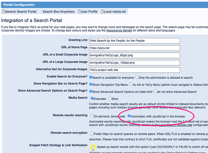

I mean when a search is performed, the results appear in a kind of random way, As new results arive they don’t appear just at the bottom of the page but pop up in the middle, or at top, and in a graphical transition. First very small, then the whole block of text grows and pushes the other blocks of text out of the way.

Edit: One of the YaCy search sites with this unusual loading came back so I screen recorded a search to show what i’m talking about. Is this “Normal”? If it is, I’ve never seen it before. My instance of YaCy never loaded results like this:
ahh – you can switch this on in /ConfigPortal_p.html
“Remote results resorting”
I actually forgot about that feature. I honestly consider to switch it on by default…
